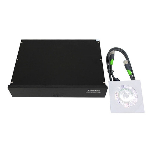

Представляю Вашему вниманию интересный транспорт, исходя из некоторых отзывов на headfi не уступающий Berkeley Alpha USB, некоторые утверждают, что превосходящий.
Singxer SU-1

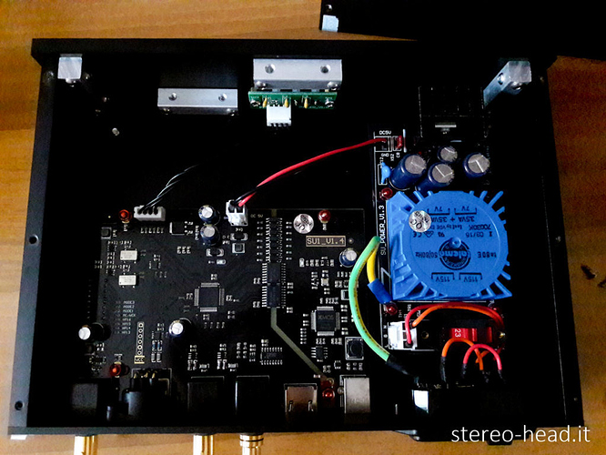

Technical features
  • Latest XMOS, xCORE - 200 series for USB digital interface which doubles in processing MIPS achieving 1000 MIPS as compared to the old XMOS chip that was commonly used.
  • Unique High-speed isolation design to complete isolating the noise between PC and SU-1. It adopted a special circuit design, using high-speed CPLD/FPGA for digital audio signal reconstruction.
  • SU-1 uses two expensive audio -level low jitters clocks (Femtosecond clock) CCHD - 575 from Crystek.
  • Five independent power supplies for all major digital parts, including ADI ultra low noise regulator driving the Crystek CCHD clock.
  • Four-layer high speed digital PCB design with impedance matched and separate ground plane and power supply layer.

SU-1 long-time research and development for nearly a year, which has gone through many twists and turns and variables.
SU-1 is the first machine we have developed equipment that is positioned in the high-end interface, is used mainly in the following three main technologies:
1, full isolation technology (ground isolation), the use of 150Mbps full-chip isolation, interference can be completely isolated from the PC;
2, source synchronous shaping technology and CPLD technology, I2S signal isolation after the re-shaping; thus eliminating the isolation chip to bring added jitter;
3, the independent development of the system clock, using CRYSTEK high-performance oscillator, low phase noise and low jitter.
