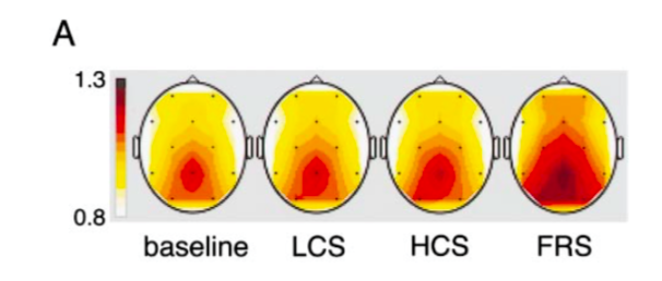

http://jn.physiology.org/content/jn/83/6/3548.full.pdf
(не слышимый человеком ультразвук на самом деле тогось, влияет)
We used the gamelan music of Bali, which is extremely rich in HFCs with a nonstationary structure, as a natural sound source, dividing it into two components: an audible low-frequency component (LFC) below 22 kHz and an HFC above 22 kHz.
Гамелан!!!
