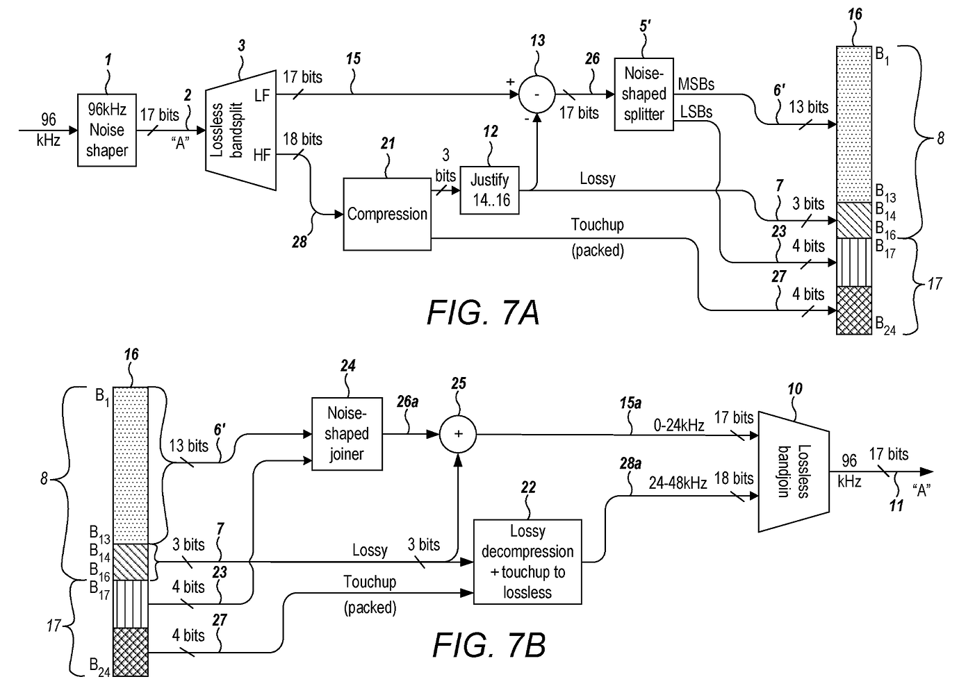

Описано в Меридиановском патенте
The MQA encoder shown in Fig. 7A accepts a 96 kHz 24-bit input. This 24-bit input is immediately reduced to 17 bits using noise shaped dither (this is a lossy dithered quantization process that adds some noise above 20 kHz). The remaining 17 bits are split into high and low-frequency channels. The split signal is transmitted through a lossy compression system that is augmented by a compressed touch-up channel. If the touch-up channel does not overload, the 17-bit transmission is lossless if decoded as shown in Fig. 7B. But, if the touch-up channel reaches its maximum capability, the system begins to be a lossy 17-bit system. After decoding, a lossless or nearly lossless version of the 17 bit signal is recovered.
