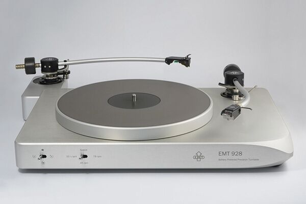

Не совсем в тему, но про EMT.
EMT 928 II record player
Ken Micallef | Aug 15, 2024
https://www.stereophile.com/content/emt-928-ii-record-player
