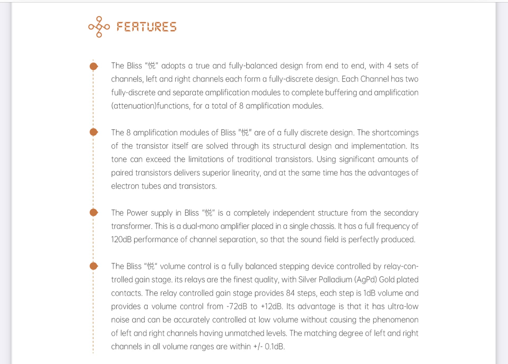

HoloAudio – Bliss Headphone Amplifier

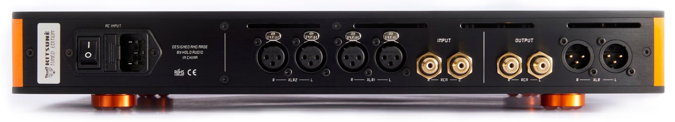

General info:
LINE IN:
Single-ended RCA input
Maximum amplitude 8.4Vrms
Input impedance 6.2KΞ©
Balanced XLR input
Maximum amplitude 16.8Vpp
Input impedance 12.4KΞ©
HEADPHONE
OUTPUT:
4P XLR Output
Low impedance mode (LO-Z): Output impedance 0Ξ©, power 12Wrms@32Ξ©
High impedance mode (HI-Z): output impedance 15Ξ©, power 2.5Wrms@150Ξ©
4.4mm Pentaconn Output
Low impedance mode (LO-Z): output impedance 2Ξ©, power 12Wrms@32Ξ©
High impedance mode (HI-Z): output impedance 17Ξ©, power 2.5Wrms@150Ξ©
6.35mm TRS Output
Low impedance mode (LO-Z): output impedance 1Ξ©, power 3Wrms@32Ξ©
High impedance mode (HI-Z): output impedance 8.5Ξ©, power 0.6Wrms@150Ξ©
LINE OUT:
Single-ended RCA Output
Maximum amplitude 10Vrms
Output impedance 20Ξ©
Balanced XLR Output
Maximum amplitude20Vrms
Output impedance 40Ξ©
Standard Bliss = 2998$
KTE Bliss = 3398$
Download Manual:
click here to download HoloAudio Bliss Manual
